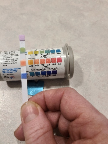

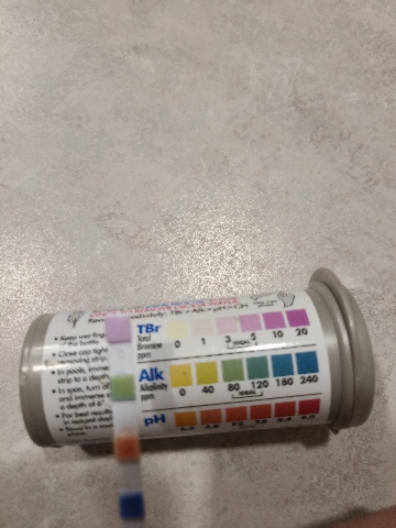

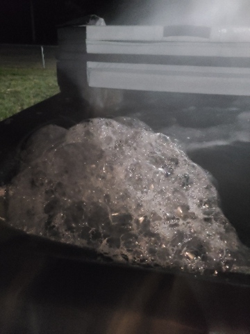

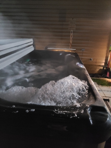

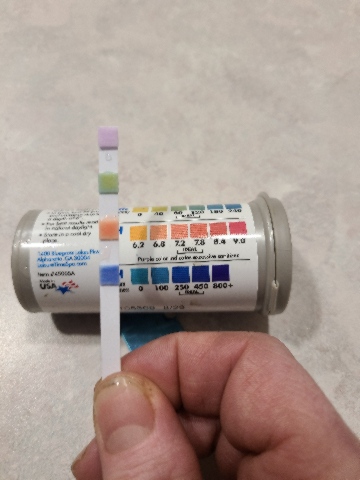

The attached pictures (if it will let me post them).... shows the foaming I get, just running spa for 10 minutes.   Looking at the chemical strip pictures, looks like EVERYTHING is in the OK ranges.

I am so so frustrated.   Once it foams up, I can use a "foam away" product, but that never seems to do the trick completely, leaves a gross buildup on surfaces the bubbles touched and it comes right back.    I was attesting it to a chemical imbalance, but like I said, it appears all in check.

A little foam, sure... a lot of foam..... mmmmm.    Those pics of foam, 12"+ ABOVE waterline is after 1-2 minutes of pumps and jets on full.   Tried scooping it out, just keeps coming back.    Ran spa through 20 minute cycles 5-6 times in a row this past weekend... constant foam.
