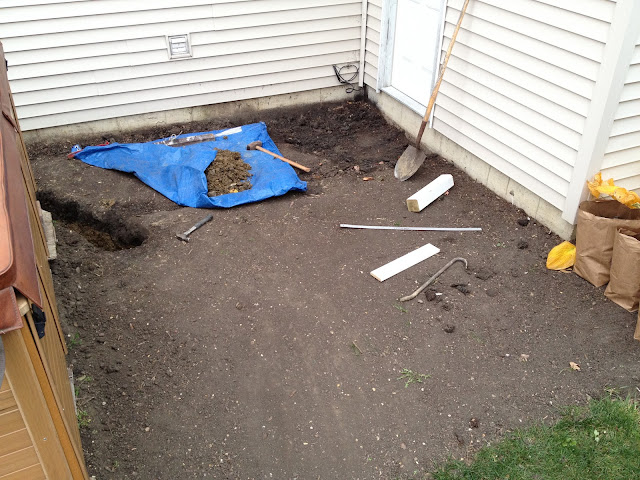

I spent most of the weekend working on getting the tub in place, and finishing the surrounding area.  I installed a paver walkway, shaped flower beds around the tub and installed a piece of privacy lattice where the house ends.
I also buried the electrical run and pulled the wires from the house side to the tub (from below the pad).  I am finishing the inside portion of the electrical this week, making the run from the breaker box to the disconnect location.
Hopefully, I'll be able to fire it up soon and see what kind of problems I have on my hands.
A few pictures of the progress:
Area as it looked on Friday morning:
Area as it looks now with tub in place:
Wiring - (18" Trench, 1" PVC, 6 AWG wire):
