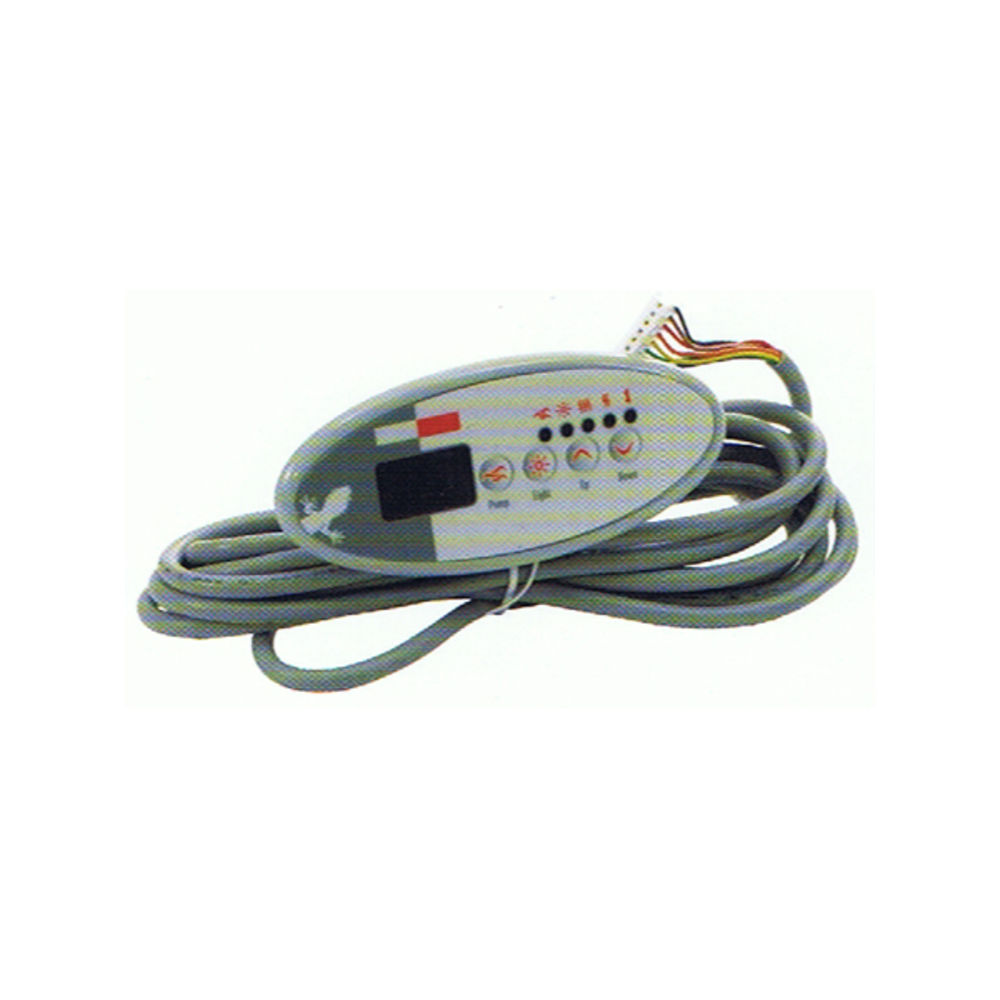

I reckon looking at the similarities, my panel is also a Gekko. Very similar to this one.
http://www.dolphinpools.co.uk/thumbnail/1000/var/files/Spa-Parts/Control-Panels/HydroQuip-and-Gecko-Panels/TSC-9__K-9__Gecko_Touch_Pad_4_Button.jpg
Only mine has a series of red dots in the temperature display window.
The only buttons I have are Temperature up, down, lamp and pump.

Try pressing the light btn then the temp btm see what comes up. If it goes from numbers to std (standard) then do it again then ec (economy) might show up, once more you might get slp (sleep). Worth a try..

I did try a host of different combinations the other evening, and couldn't find anything.
If I'm being honest, it's not so much a sleep button/combi i'm looking for.
As this would still require me going out around the back and putting it into sleep mode every evening.
I was hoping that I could switch it off from the house at night, and switch it back on the next morning when the PV's were generating, thus not have to interfere with the tub.
I could still do this i suppose, but the temperature defaults to 92°F.
I've scored the net and found a whole host of manufacturers using this panel under their own guise, and not one of them mentions being able to change this default, so it looks like i'll have to live with it.
It's probably hard coded in the eprom.
